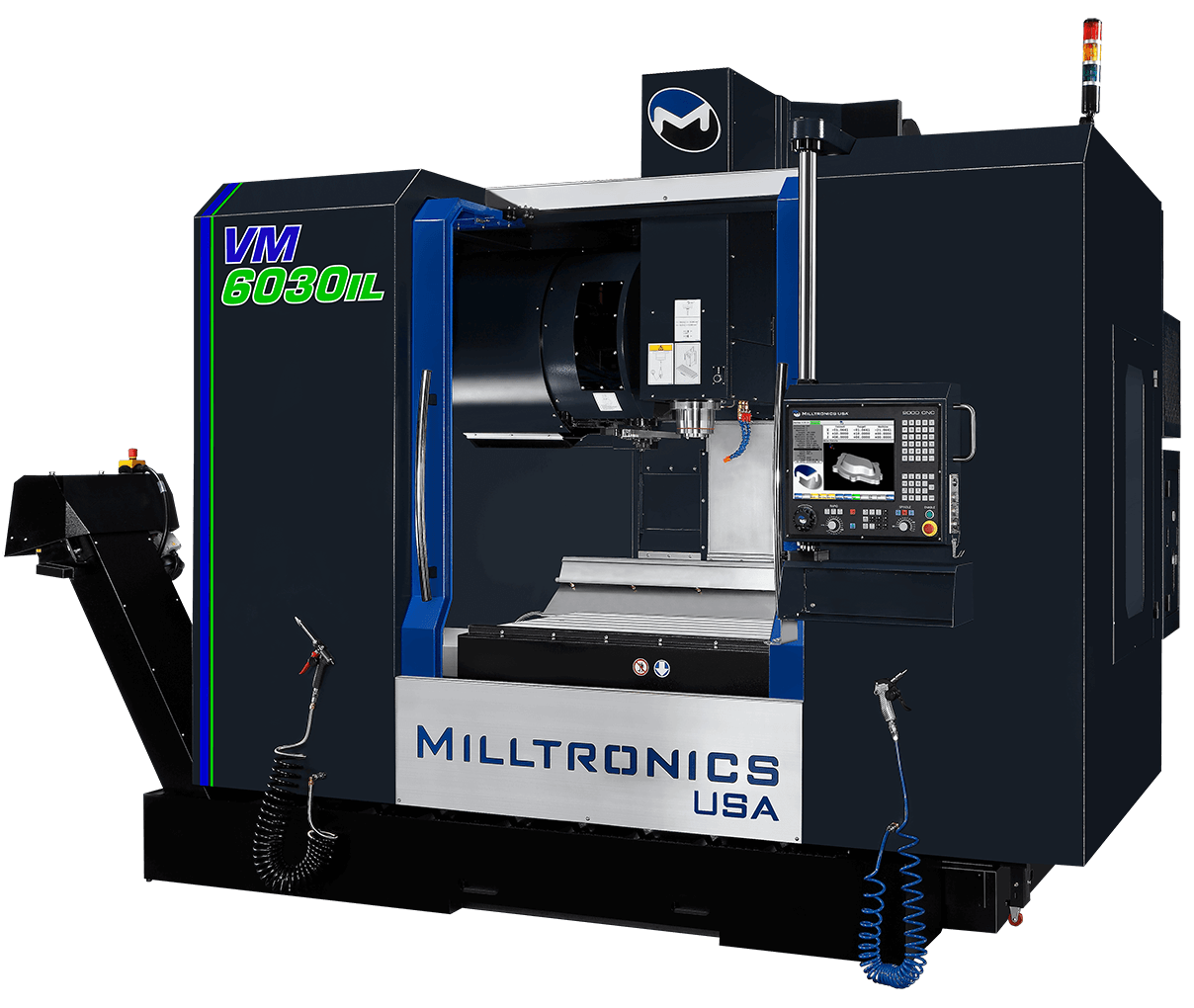

VM6030IL
VM6030IL
3-Axis Performance Vertical Machining Center
Our biggest inline spindle machine at 60″ x 30″ x 24″, the VM6030IL has a 66″ x 30″ table and a 24 HP dual wound 12,000 RPM BIG-PLUS spindle.
Additional Resources
Machine Specifications
Additional information
Weight 21800 lbs
Dimensions 115 × 150 × 123 in
CAPACITY
Travels
60 x 30 x 24 in
Table Working Surface
66 x 30 in
Max. Weight on Table
4190 lbs
Table T-Slots
.71 in
SPINDLE
Spindle Taper
BIG-PLUS® ISO No. 40
Spindle Speed
12000 RPM
Spindle Power
35/25 HP
Spindle Torque
122 ft-lbs
Spindle Nose to Table
4-28 in
AUTOMATIC TOOL CHANGER
Tool Shank
CT40
Retention Knob
MAS 60
Tool Capacity / Type
30 / Double Arm
Max. Tool Diameter
3.15 in
Max. Tool Length
11.8 in
Max. Tool Weight
15.4 lbs
MOTION
Rapid Traverse Rate
1000/787 IPM
General Details
Machine Weight
21800 lbs
Machine Height
127.6 in
Footprint
149.8 x 149.4 in (184.4 in with conveyor) Nominal Operating (W x D)
Power Requirement
34 KVA / 84 Amps
Voltage Requirement
208-240 Volts / 3 Phase
