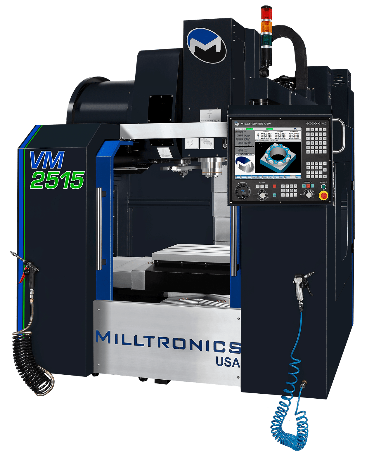

3-Axis Vertical Machining Center
The Milltronics VM2515 has 25″ x 15″ x 20″ travels and a 30″ x 16″ table that supports 3,140 lbs table weight at full speed. The VM2515 has a 15 HP 10,000 RPM BIG-PLUS® spindle.
