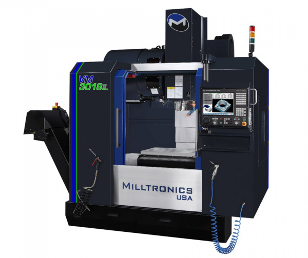

The Milltronics VM3020IL has 30″ x 18″ x 22″ travels and a 34″ x 20″ table that supports 3,140 lbs table weight at full speed. The VM3020IL has a 24 HP 12,000 RPM BIG-PLUS spindle.
