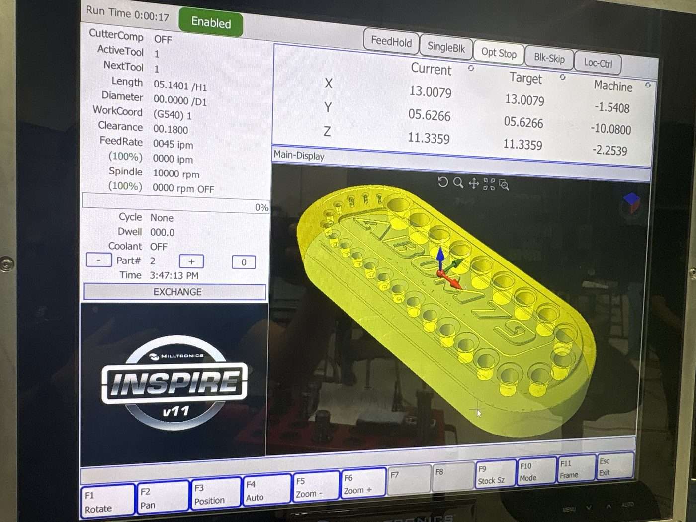

Through the power of our INSPIRE+ control and platform, our engineers have been able to achieve full integration between Milltronics machines and Procobots ProFeeder automation systems. These systems include a robotic arm, gripper, and one or more grid-based tables to store blanks and parts. Deployment of automation has never been easier.

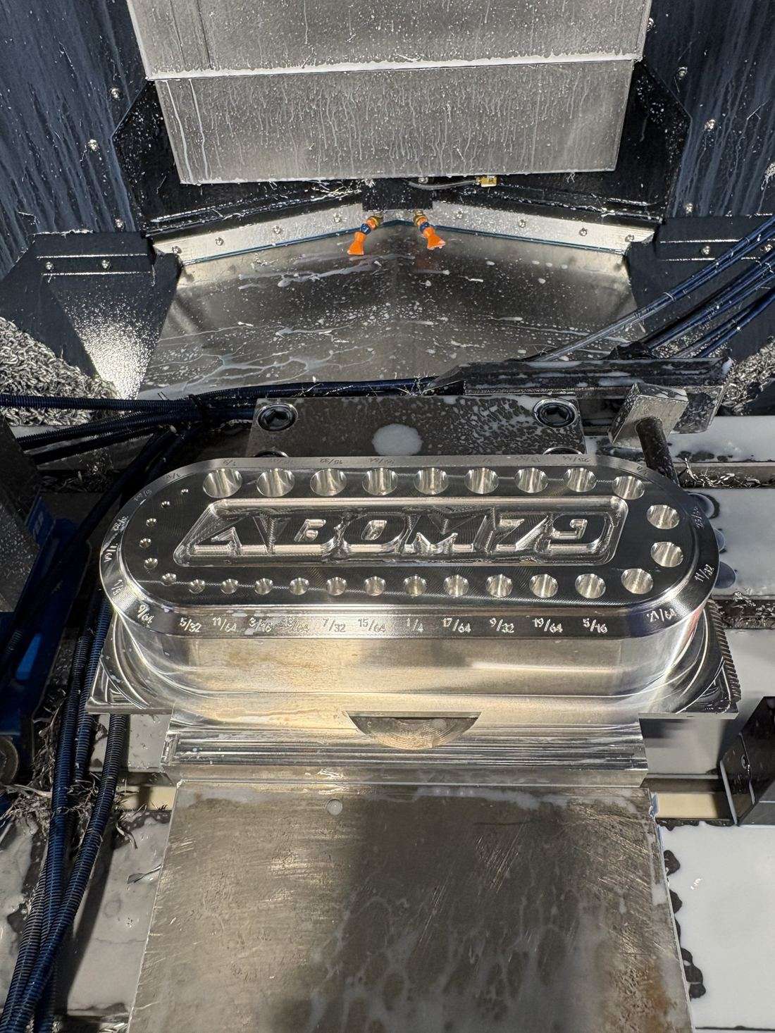

Using conversational programming on the INSPIRE+ control, job setup is a breeze. In setup mode, the robotic arm can be easily maneuvered by hand. The operator moves the gripper to a spot on the grid that contains raw stock and allows it to clamp, unclamp, and re-clamp the workpiece. They then manually guide it through the machine's open doors and into the workholding. From that process, the system automatically calculates an optimal path for loading workpieces and unloading finished parts.
Once the setup is finished, it's as easy as telling the control which positions on the grid contain stock for the job at hand. The system will automatically load and unload the machine until the job's complete.
Abom79 drill index workpiece clamped in the vise inside a Milltronics VM3020IL during machining
A workpiece loaded into the VM3020IL's workholding by the ProFeeder system.
INSPIRE+ control screen displaying the part program during an automated machining cycle
The entire cell, machine and robot, is run through conversational programming on INSPIRE+.

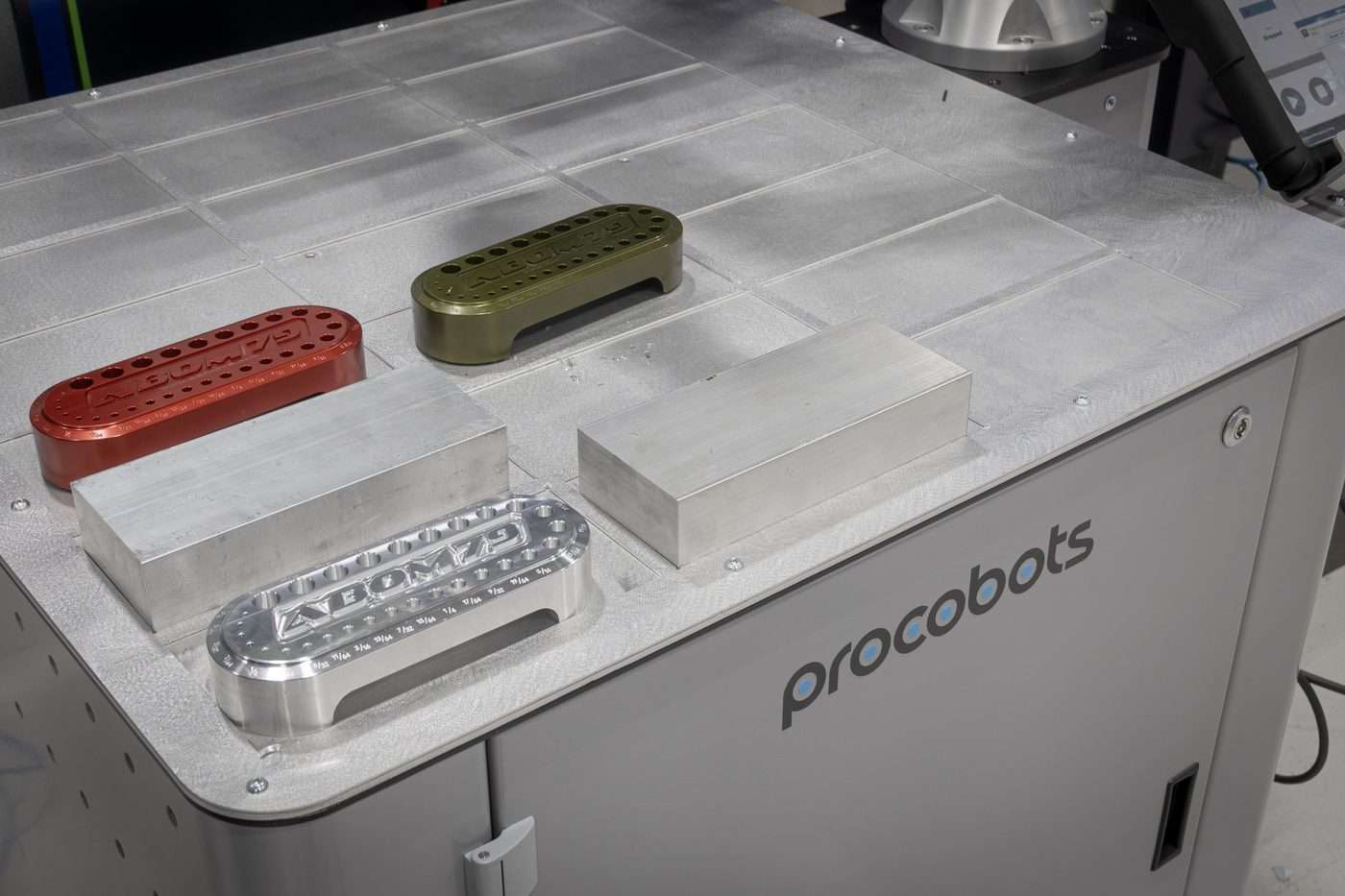

Additionally, while the Procobots ProFeeder system includes a grid with 24 pockets, it's very affordable to produce grids with different sizes and quantities of pockets. The default system uses a single grid, but shops can optionally select stacked tray orientations that incorporate either five or ten drawers that are automatically accessed.
Procobots ProFeeder grid table holding raw aluminum blanks and finished anodized drill index parts
The ProFeeder's grid-based table holds raw blanks and finished parts, here, drill indexes from the IMTS 2026 demo.
